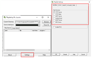

■ Configure tftpd64
 1.Check GLOBAL Start Services from Settings to TFTP Server only.
 2. On the TFTP tab, specify the path where the file to be transferred is placed in "Base Directory".
  Others have not been changed from the default values.
 3. "Current Directory" is the path where the files to be transferred are placed, and "Sever interfaces" is the transfer source.
  Set the IP address of your PC.

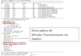

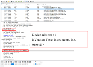

Phenomenon 2
Even in the USB packet capture, the Device address changed and the Device information was reacquired.
Phenomenon 3
The value is notified as Disconnect in the CDC command "NETWORK CONNECTION" of the USB COM protocol.
Please let me know if you have any advice or countermeasures for phenomena 1 to 3.
