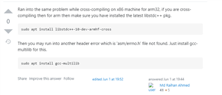

We have tried below solution as well, but we are not able to resolve the issue.
Please help us to solve the problem
