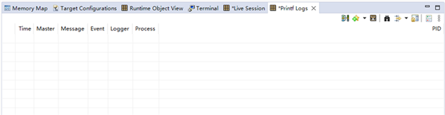

Hello Champs,
sys/bios: bios_6_76_03_01
uia: uia_2_30_01_02
Customer failed to use Log_info1 API, there is no output.  But System_printf can output information.
He has added logger in cfg
