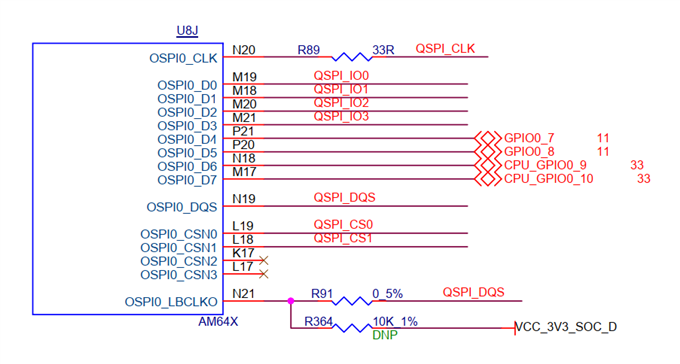

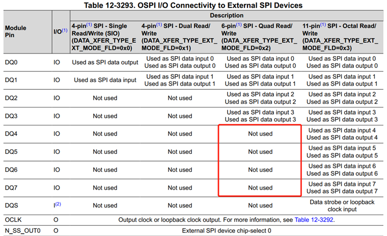

AM6442 can access a qspi flash by ospi interface.In this condition,can other 4 DQ lines(DQ4,DQ5,DQ6,DQ7) be used as GPIO?

Hello jimin.li
Thank yo for the note.
From the SoC device point of view, this is feasible.
Please refer to Table 6-1. Pin Attributes of the datasheet.
Sreenivasa
