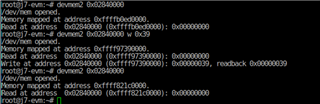

Question 2: I used the devmem2 tool to read the data of the UART4 address 0x02840000 register, but when I use the devmem2 tool to write the value to the register address 0x02840000.I indicate that the write was successful, but the value did not change when re-reading.
    Which SDK version are you using, we need to check if UART4 is owned by Linux or is it reserved for RTOS.

    a. It is ti-processor-sdk-rtos-j721e-evm-08_01_00_13.
    b. At the same time, the UART5 UART_DLL address 0x02850000 and UART_DLH 0x02850004 registers cannot be written. Could you help to check it?
    Customer also wants to know how to modify the baud rate of UART5 through registers? And what is the register address of UART_DLH and UART_DLL?
    Can you please check if UART5 is enabled in the dts file? If not, please enable it in the dts and then try again.
    Also, I found reference code from on of the previous SDK versions. Please find the code attached Lin_diag.zip. You can use this as reference.

    Found in this k3-j721e-common-proc-board.dts file as follows: main_uart is disabled
    1. What does the main_uartX node mean?
    2. Do disabled and enable mean that the main_uartX node can be used in the MCU?

  • Hi Annie,
    These nodes represents the main_uart instances that are exposed to Linux. If a particular node is disabled then you cannot modify it's registers from Linux using devmem2.
    I am not sure if I understand this question correctly, but if you enable a node, then that uart instance is owned by Linux and you won't be able to use it with an RTOS application. In that case you should modify the registers from RTOS application itself or from CCS for debugging purposes.
