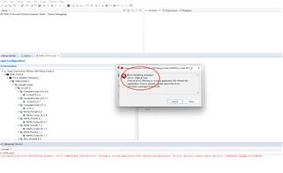

In CCS10.4.0.00006_WIN64 ,XDS200 Debug , environment .
When I was creating the CCS project, the following error was reported:

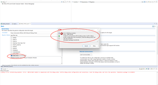

Hi Chen,
If you are using on-board emulator, then please choose XDS110 for connections in general setup while creating the ccxml file.
Parth
