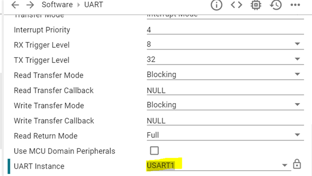

  • Hello I,
    Could you please try changing the UART number in your example code and perform the same test?
    The Hello World example code uses USART0 and you can try changing from USRAT0 to USART1 and do the same test.
    Please confirm if this helps to resolve your issue.
    S.Anil.
  • Hello Swargam,
    Without enabling UART log component in sysconfig putchar_() in ti_dpl_config.c is just an empty stub.
    That explains why with default example configuration nothing is printed out.
    With the component enabled UART instance is Any(UART1) by default. Changing it to UART1 did not help. The core
    is still looping infinitely after the Sciclient_sendMessage() call.

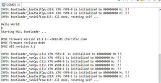

  • Hello ilya,
    I didn't face any problem while loading Hello World example on A53 core from CCS.
    I have followed the below steps to reproduce the your issue and please let me know if I have made any mistakes in reproducing the your issue.
    Steps :
    1. Kept the HW into UART Boot Mode
    2. SBL NULL image Flashed on external Memory ( OSPI )
             3. Kept the HW into OSPI Boot Mode and Removed GEL scripts from the CCS to avoid DDR  initializations again.
             4. Connected to A53_0 Core
             5. Loaded Hello world example on A53_0
    I hope you solved your issue and please let me know if you face any problem .
    S.Anil.
