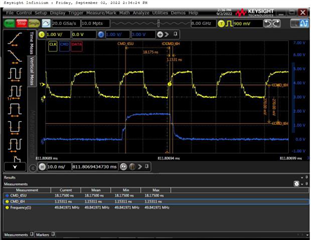

hi expert:
 now , I have a question about the input hold time , according to the sumsung emmc spec , the  min is 3ns , but the result of our dev is 1.15ns ,
now our system is based on Linux sdk8.0 .with next node , how can I upate the params to meett the gaps of input how timing

  • Hello Yolanda,
    It appears you are attempting to run at the HS400 speed mode, which is not supported on TDA4VM (see errata i2024).
    The line "mmc-hs400-1_8v;" should be replaced with "mmc-hs200-1_8v;" in order to run eMMC in HS200 speed mode (the highest supported speed on the device).
