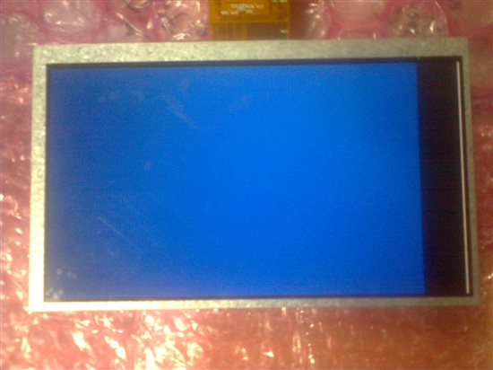

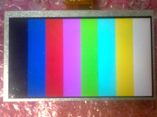

after the system start, we can see the color bar in the lcd :
but if we remove this line,
dispc_reg_out(VENC_VDPRO, 0x903);
 we get :
i dont kown what's the problem.. and stil  i cannot see the linux log and .. the app of qt example cannot be display in the lcd.
we even tried with decode etc, but no luck.
Any help will be appreciated. thinks in advance.
regards, Mike.

    if we try with
    ./fb /dev/fb0 255 0 0
    the lcd turn to blue and  it is the same below:
    ./fb /dev/fb0  0 0 255
    this one turns lcd to be cyan...

    the lcd dispaly the color bar in the lcd after running my code:
    red
    blue
    green
    red/blue
     but .. it should display the color bars like this :
    red
    blue
    green
    red/blue
  • I assume that the images are full screen and no black regions omitted, I would guess that your LCD scans vertically rather than horizontally. The origin could be top left or bottom left. Your code looks like it writing out 4 lines but you get 4 large blocks. Implies that the LCD itself uses a lot less than 4 bytes per pixel. Also, are you sure that your LCD is interlaced?
    I am not familiar with the DM365 LCD controller. Does it do format conversion? Does it allow origin and scan direction to be set? Or is the frame buffer passed through to the LCD without change? The frame buffer format might be diffferent than the LCD format.
  • Thinks, Norman Wong.
    i think we resolve the problem by configure the pin of the lcd to the mode of SYNC rather then DE mode.
    then it works.
    it is  may be the problem of interlaced..
