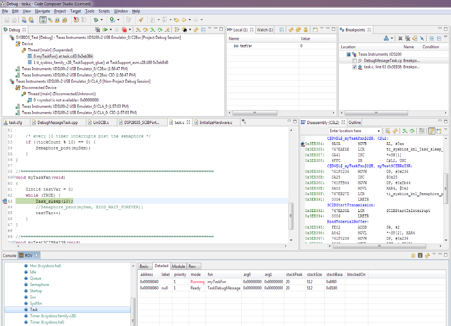

  • Can you describe in more detail exactly where Task_sleep() is being called from and when?
    Have you tried using the ROV tool to examine the state of your Task instances at various points, especially just prior to the call to Task_sleep()?
  • Hi David,
    I attached a screen capture of where I am calling it.  After the Task_sleep() is called, the other task "TaskDebugMessage" does not get to run because the program has stopped in abort().
    What are the things I should be looking for to debug this issue in ROV?
    Thanks.
    Stevenson

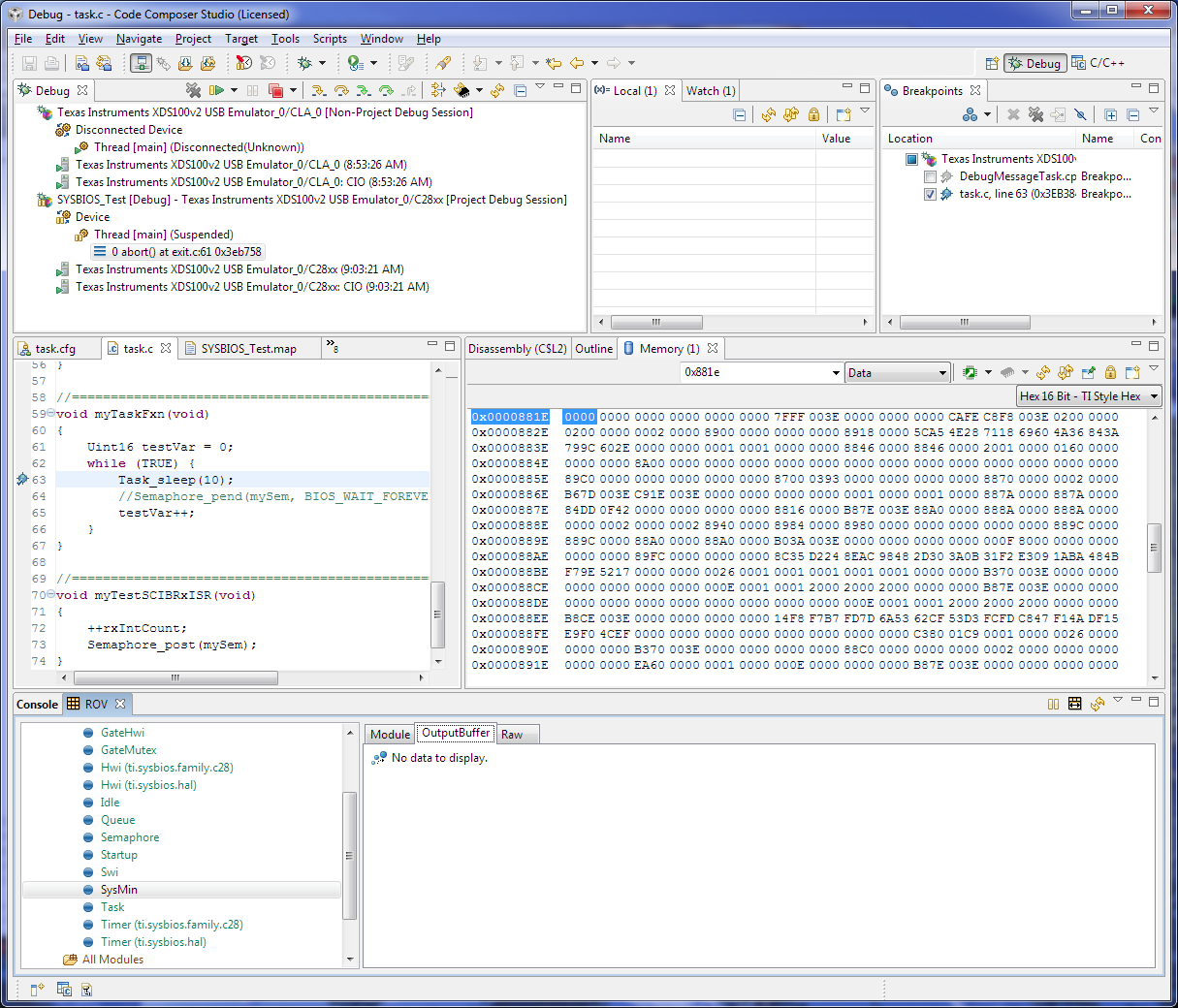

  • Stevenson,
    The following lines in your .cfg file indicate that you are using the 'SysMin' system support proxy.
    SysMin.bufSize = 0;
    SysMin.flushAtExit = false;
    System.SupportProxy = SysMin;
    This means that all output from your application is channeled into a buffer in memory.  Moreover, your application is configured to not flush this buffer when it exists.  It was probably configured this way to lower footprint on C28x devices.
    We might be able to get more information about your problem by examining this buffer for any output placed there prior to the abort().  Refer to the ROV view for 'SysMin' (which is right above 'Task' in the screenshot you attached) and please post the contents of the SysMin buffer.

  • Hi Shreyas,
    I posted the screen capture while inspecting the SysMin buffer.
    It also did not make a difference when I removed the entire module for SysMin (still aborts).
    Thank you.
    Stevenson
