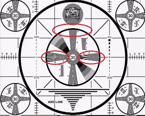

I use dm365 to capture BT.656 video. I set the capture driver in continuous mode,
The drivers doc say like this" Continuous/On the fly mode capture mode through previewer and resizer, the driver uses bottom field and scale it up vertically by 2x to get de-interlaced video. The interlace data cannot be captured in this mode."
The top field should be throwed away directly. but I have no idea how the driver do that?
The key point is that the de-interlaced video is bad in vertical resolution. On the other hand, I need to use resizer to scale the video sometime. So I want to know if resizer can deal with the interlaced video directly?

    In  continuous mode, that is, ISIF(CCDC) and IPIPE(previewer and resizer) is chained together, I thought it was possible to get interlaced frames. But now, I guess IPIPEIF only send one field video tho the IPIPE for interlaced video(I am now trying to validate it ). Even if my guess is not right, I donot think the IPIPE can deal with interlaced video very well, it may not  identify interlaced input or progressive input, it may always deal with the input video as  progressive and think the video comprised of odd  field and even field is a frame video. This is my analysis.
    Nagabhushana said:
    Are you observing bad video in your set-up?

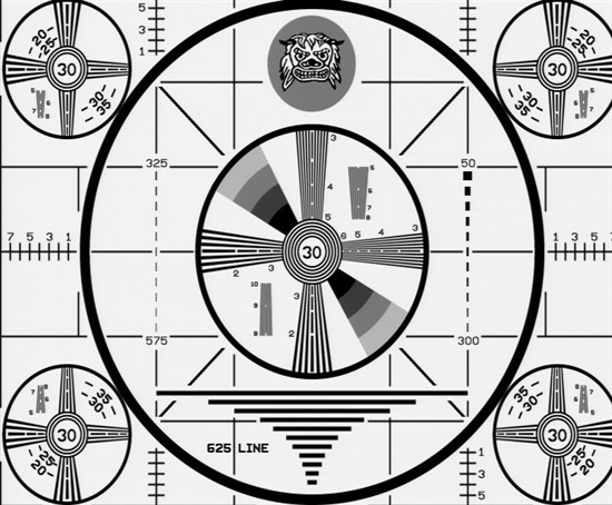

    Below is the original video and the captured video by dm365 in continuous mode.
    I really have no idea if a interlaced video can be properly dealed by IPIPE, except it can use bottom field and scale it up vertically by 2x to get de-interlaced video.

    I suggest you to capture this same frame/video from CCDC/ISIF. And then compare the video with the one you mentioned as faulty.
    Note:- The constraint mentioned in doc is referring to driver implementation which captures de-interlaced video. So, applications can't get interlaced frames.
  • Hi Nagabhushana,
    Today I have tested the method you said, there is no problem with the video captured from ISIF directly. In fact, I would be able to solve the resolution problem in my application by running the VPFE drivers in Single Shot mode but not in Continuous mode. It is just more complex for my application, because I need to use resizer to resize video and convert the colorspace type in addition. If the two functions can be realized in continuous mode, it would be perfect.
    Furthermore, for dm365, if I donot want to use the simple de-interlace method above(capture run in continuous mode, that only use bottom field), which is bad for still video, is there other method to realize the de-interlace?
    Thanks.

    I feel these kind of artifacts are possible with interlaced mode as resizer hardware applies filters which depend adjacent pixel values to determine certain pixel value. Also is you see, it is happening for lines with certain slope(angle).You might want to test this for some other kind of video frames.
