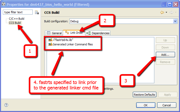

  • It's not clear to me what exactly the issue is.  Here's something to try though.  I saw an issue related to code gen 6.1.11 where it was pulling in more pieces of a library than truly necessary.  Perhaps in your case this same issue is happening, but because the same function names are being used it ends up causing an error.
    This wiki page tells how to update your compiler/linker for CCS 4:
    http://wiki.davincidsp.com/index.php/Compiler_Installation_and_Selection

  • I don't think v6.1.12 will fix this problem.  If it doesn't, please build again, but add the linker option -scanlibs.  That option causes the linker to issue messages which indicate, for every symbol found in multiple libraries, which library is used.  Then please post the linker messages, along with the map files, here.
    Thanks and regards,
    -George

  • I had another customer mention a very similar issue.  They weren't getting the linker errors (nor could I reproduce that issue) but were having issues getting the fastrts functions linked into the final build.  This issue resolves around the order in which the libraries are passed to the linker.  Back in your initial post I see that in CCS 3.3 the fastrts library was being passed to the linker prior to the generated linker command file from BIOS.  That's the key step.
    In CCS 4 you can specify the link order as follows:
    • Right-click on the project and click Properties
    • Click on CCS Build
    • Click Link Order
    • Click "Add" and then add the fastrts library.
    • Click "Add" again and add "Generated Linker Command Files"
    Now the resulting build will be something like this:
    'Building target: dm6437_bios_hello_world.out'
    'Invoking: Linker'
    "C:/Program Files/Texas Instruments/ccsv4/ccsv4/tools/compiler/C6000 Code Generation Tools 6.1.14/bin/cl6x" -mv64+ -g --diag_warning=225 -z -m"dm6437_bios_hello_world.map" --warn_sections -i"C:/Program Files/Texas Instruments/ccsv4/ccsv4/tools/compiler/C6000 Code Generation Tools 6.1.14/lib" -i"C:/ti/c6000/62x64xfastrts/c6400/mthlib/lib" -i"C:/Program Files/Texas Instruments/ccsv4/ccsv4/tools/compiler/C6000 Code Generation Tools 6.1.14/include" -i"C:/Program Files/Texas Instruments/ccsv4/bios_5_41_00_06/packages/ti/rtdx/lib/c6000" -i"C:/Program Files/Texas Instruments/ccsv4/bios_5_41_00_06/packages/ti/bios/lib" --reread_libs --rom_model -o "dm6437_bios_hello_world.out" -l"fastrts64x.lib" -l"./bioscfg.cmd"  "./main.obj" "./bioscfg_c.obj" "./bioscfg.obj"
    I hope perhaps that clarifies for some other people in the future!  To the original poster, sorry I didn't try this out a little sooner though I'm glad you figured out a suitable solution even if it was a bit of a hack! ;)

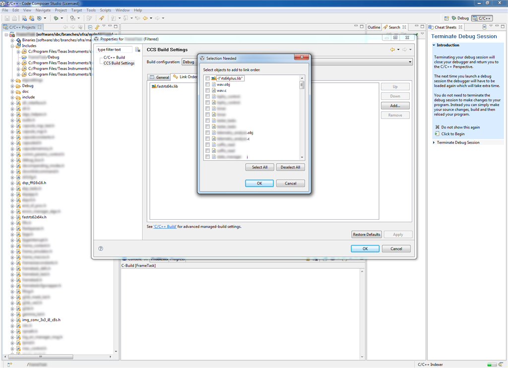

  • Older version of CodeComposer 4 installed on my machine had this option and I could build the project with BIOS 5.4.xx.
    New installation just does not have the option to specify "Generated Linker Command Files". It does not exists in "Link Order"-"Add" dialog. Was it removed in recent versions?
    If so, how can I resolve this issue now?
    Thank you in advance
  • What version of CCS are you using?  I just checked in CCS 4.2.0 and the ability to use "Generated Linker Command FIles" still exists.  I'm updating to 4.2.1 right now.
  • I just updated to 4.2.1 and I still see the option.  Please attach a screenshot of what you see when you click "Add".
  • Now, that TI's auth mechanism is back up, I may post a response.
    After additional testing, I undrestood that I was wrong and the CC that does not have "Generated Linker Command Files" is the CC 4.0 and not 4.2.
    And it does not want to upgrade itself via the "Help"-"Software Updates". Was this option present in some form in 4.0?
    Thank you in advance,
  • I'm not sure if that was present in CCS 4.0 in some other form.  I assume that if it's not where you're looking that it's not there at all in CCS 4.0.  Your best bet is definitely to upgrade to the latest.  There have been MANY fixes and improvements.  In terms of your upgrade issues, when the box comes up asking if you want to search for updates to currently installed products or look for new products, make sure you click the "new" products.  When you choose "currently installed" it will only show you 4.0.x updates but if you select "new" then you should see an option for 4.2.x.  I can't remember if it will update you directly to 4.2.1 or if it goes first to 4.2.0 and then you have to do another update to 4.2.1.  If that's the case it's probably faster/better to just download and install the latest (4.2.1) directly.
