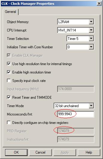

  • Check the contents of the CLK Manager (see attached). The microseconds per tick is typically about 1000 so that a tick occurs every 1ms. This programs the Timer's Period (PRD) register with a specific value that will generate an interrupt every 1ms. I've circled both of these fields in the attached photo.
    As I mentioned before the only reason I know of that causes the TSK_sleep() to take so much time is the fact that the simulator runs slower than actual hardware. This is because the simulator has to simulate everything in software which is slower than hardware. If your tick time is small you should be able to see the tasks return on the simulator even if it runs slowly.
  • Dear Tim,
    TCI6487 has only two timers.also the hardware interrupt is in gray color ( which i cant change).
    However I have changed the clock manager parameters as per the image you attached.
    Still,it runs as-usual. (i.e task time remaining is 1 after long time. [10 mins])
