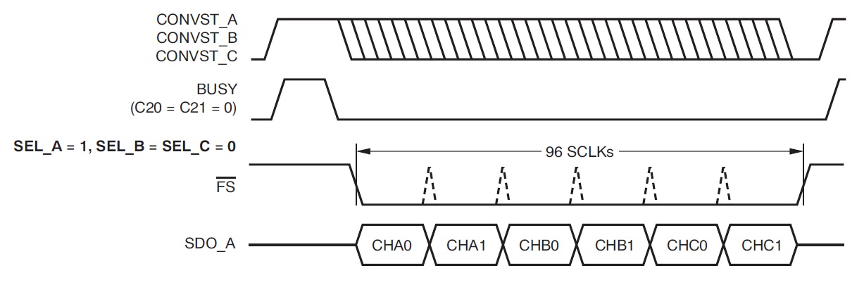

I am using a C6713 with high-precision ADS8556 ADC's.
Here is my situation to receive data from ADS8556 using McASP.
I have 6 channels of data coming from ADS8556 coming into the McASP1 serializer 5 (say)
in TDM Mode and another 6 channels of data coming from another ADS8556 into serializer 6
also in TDM mode. How do I set up the McASP for the operation especially to get a frame-sync that is low for 96 clocks?
Please see the following timing diagram that the ADC expects especially the frame-sync.
Also CONVST_A/CONVST_B/CONVST_C in the design is tied to GPIO5/EXT_INT5.
How can I generate the CONVST_A pulse as can be seen if I were to use DSP/BIOS?

  • Gus,
    I am attaching the timing diagram that I want to meet.
    The CONVST_x signal in the diagram is tied to the GPIO5 signal in the design.
    I have to generate the CONVST_x signal as shown with respect to the FS signal from the McASP.
    I have generated the FS signal as we discussed before (using 7 TDM slots).
    This is going to be a problem.  There is no good way to accurately control the timing of the GPIO signal wrt to the frame-sync output of the McASP.
    I don't know if this is possible in your design, but blue wiring the frame-sync output of the McASP to the CONVST_x signal should work.  When the frame-sync signal goes high, it will force the ADS to start a new conversion.  Since the frame-sync will stay high for a total of 16-clocks, the timing tCONV should be met.  The BUSY pin should also be low long before the frame-sync signal goes low (i.e. assuming a 27MHz clock rate and a 16-bit slot size, FS high time = 37ns x 16 = 592 ns >> tD1 .  The timing t1 should also be easily met.  The only timing that will not be met is t3, since the frame-sync signal will go high immediately after the last clock thereby initiating a new conversion.  I am not sure if this will be a problem for the ADS device.  I recommend you start a new forum thread on the data converter forum.
    I don't see any other option to implement what you need.  It looks like the serial interface on the ADS device was designed for a SPI port.  Since the McASP does not support clock-stop mode, it is not well suited for this use case.  The McBSP would have been a much better option.
