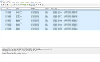

We are facing the issue with PRU Ethernet on AM6548 SDK 8.2 SR2. We have observed that intermittently there is no rx packets on the PRU ethernet whereas tx packets are properly increasing. rx - packets are stuck at particular value or maybe at 0. we can see the DHCP request being broadcasted on network and also we are getting the packets reply from DHCP server but if we see the packets count in PRU ethernet we dont see a increase in rx looks like PRU ethernet is stuck for some data or maybe in unknown state waiting for some data. I am attaching the wireshark logs and also shell console logs where you can see rx packets are stuck at a particular value.

~ # sudo udhcpc -b -B -A 30 -t 5 -T 3 -R -i eth1 -s /etc/udhcpc.script
udhcpc: started, v1.33.2
udhcpc: sending discover
sh: missing ]
udhcpc.script: DHCP failed, falling back...
/etc/init.d/ntpd: NOTICE: Wait 5 secs more for service '18246' to stop.
udhcpc: no lease, forking to background
