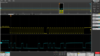

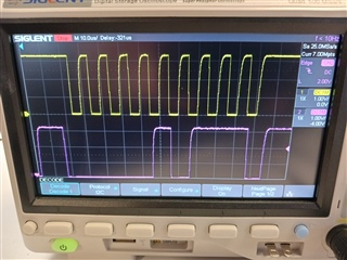

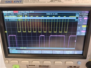

Hi TI team,
We are seeing unknown busses( Meaning it through very random busses which are not connected in our design)  in our custom TDA4VM hardware when we are operating I2C bus in 100Khz frequency. Please find the snapshot of I2C busses we found when we perform ‘’ I2Cdetect’’ function in our custom hardware.
As per our design on MCU_I2C bus we have total 8 slaves as per below table which are connected in daisy chain fashion in our PCB. When we perform ‘’I2cdetect -y-r-0’’ command we see random I2C slaves are detected which are not presented in our design.
In the same time when we move the I2C speed to 400Khz, we don't see any Unknown devices or ghost devices. it works correctly. would like to understand more or suggestion on the same.

    Couple of reasons from our I2C expert:
    • Glitch due to interference / Wrong pull up.
    • Slaves that work only at 100K?
    Could you check with your schematics if the expected slave IDs in the above list are the only ones that are connected?
    Keerthy
  • Hi keerthy,
    Thanks for the feedback. I will check with my software team check the slave ids as per above instructions. Regarding the other feedback i have other comments.
    • [Chaitanya]: We are using 2.2K Pullup by default. however we have modified the pullup values from 1K , 1.2K, 1.5K, 1.8K, 2K, 2.5K, 2.7K, 3K, 3.6K and 3.3K, still the behavior is the same. we see ghost address randomly on the board when we are operating I2C in 100Khz frequency.
    • Note to mention we don't see any ghost address in 400khz frequency. Also in the layout we have taken care in the PCB routed I2C signals in Daisy chain fashion with continuous ground.
    • [Chaitanya]: All the slaves connected on the bus supports from 100Khz to 400Khz frequency.
    I have double checked with my schematics and we don't see any other slave IDs connected other than i have mention in this thread.

  • Uncommenting the "sleep 1" allows me to capture the problem on an oscilloscope. I've done several captures, but I will present only one here.
    1. The false address in this capture is read of "0x05", or bus access "0B".
    The analog waveform looks good, no ack present.
    The decode feature confirms this
    The error occurs as the last of a burst of accesses, followed by bus idle of around 8 ms.
    There are also some very long I2C clock streching segments, but since these are present every time I will assume this comes from our peripherals, and is not a bug.
