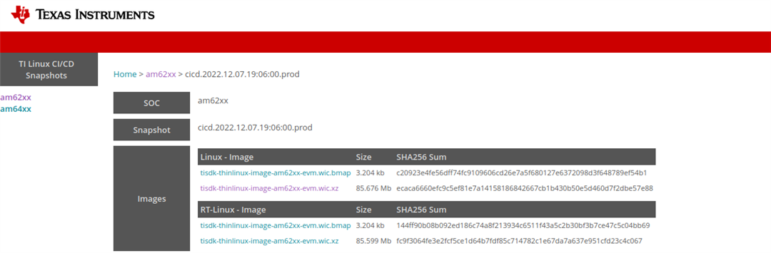

      HDMI video/audio was not working after applied the given patches in the specific directory of SD card & downloaded your files of k3-am625-sk.dtbo &  k3-am625-sk-hdmi-audio.dtbo.
      Previously the HDMI video was working without applying patches & flashed your given dtbo files.
      Can you please tell us why the HDMI video was not working, if we flashed your dtbo file & jumpered the J24 pins on the unit.
       Steps to play the HDMI audio on the unit.
       1. Copied your images (two dtb files) on our unit.
       2. Added the line "name_overlays=k3-am625-sk-hdmi-audio.dtbo" in the uEnv.txt.
          Attached the  u-boot print environment log:

  • Hi Lakshmi,
    Can you verify with the latest code base and images, you are still seeing the issue?
    https://software-dl.ti.com/linux-cicd-report/index.html?section=snapshot&platform=am62xx&snapshot=cicd.2022.12.07.19:06:00.prod
    Please short the J24 and with the latest code bas, create the dtbo files and change the uEnv.txt to boot with overlay changes.
    Let me know if you still have issues.
    Suren
    We followed your link to download the SD card images & flashed into our unit.
    Observed the below log, but the HDMI audio was not working.
    root@am62xx-evm:~#
    root@am62xx-evm:~# uname -r
    5.10.153-g3eee621d16
    root@am62xx-evm:~#
    root@am62xx-evm:~#
    root@am62xx-evm:~# aplay -l
    **** List of PLAYBACK Hardware Devices ****
    card 0: AM62xSKEVM [AM62x-SKEVM], device 0: davinci-mcasp.0-tlv320aic3x-hifi tlv320aic3x-hifi-0 [davinci-mcasp.0-tlv320aic3x-hifi tl]
      Subdevices: 1/1
      Subdevice #0: subdevice #0
    root@am62xx-evm:~#
    HDMI audio playback command (Jumpered the J24 pins)
    root@am62xx-evm:~# aplay -Dplughw:0,0 16_48k_PerfectTest.wav
    16_48k_PerfectTest.wav: No such file or directory
    root@am62xx-evm:~# aplay -Dplughw:0,0 /piano2.wav
    Playing WAVE '/piano2.wav' : Signed 16 bit Little Endian, Rate 48000 Hz, Stereo
    aplay: pcm_write:2059: write error: Input/output error
    [  603.701785] ti-udma 485c0100.dma-controller: chan1 teardown timeout!
    Please share the dts file & uEnv.txt or wic SD card image.

    I was able to play audio with the thin image you had attached previously with J24 pins shorted on my E2 AM62-SK board.
    All I had to do flashing that image was:
    1. change the uEnv.txt in boot partition to add line: name_overlays=k3-am625-sk-hdmi-audio.dtbo
    Once the board boots up:
    2. stop weston : /etc/init.d/weston stop
    3. Run kmstest to view the multi-colored square pattern on HDMI display.
    4. speaker-test -D plughw:0,0 -r 48000 -c 2 -t sine -f 1000 to see if audio works fiine on HDMI.
    You would not be able to play with GStreamer with the thin-image.
    You can build the default image following the Build instructions on CI/CD snapshot page  from the link below: and in Step 5 (Run Bitbake) use
    MACHINE=am62xx-evm bitbake -k tisdk-default-image
    Ref Link: software-dl.ti.com/.../index.html
    With the default image I was able to play video and audio both on HDMI with the same procedure and using
    gst-launch-1.0 audiotestsrc ! autoaudiosink videotestsrc ! kmssink driver-name=tidss
    Let me know if this solves the issue.
