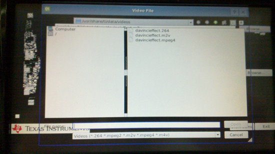

Hi, all
since i had read more here,and  here,(i have to move the post here cus no one is there :) sorry about this)
but i still get problem to get the target:
display qt widget overlay the video (yuv or h264 )  with color key enable.
i had tryed with qtInterface:
i had tired with 's suggestion and after a small modifications to fit my LCD 800x480, i run the app as
./qtInterface -y 8 -O 6  -bg transparent -qws
-y 8 is add to support the custom LCD.
And i think "-bg transparent" is useless here,so i change the source code with
#ifdef Platform_omap3530
    QWSServer::setBackground(QBrush(QColor(0, 0, 0, 0)));
#endif
 //mike add to test transparence
cus we are using dm365 custom borad.

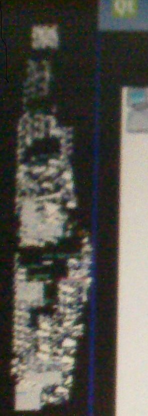

and then we get the picture you can see above. i think the transparent is already done, but..
after the pen skiing on  the left part of LCD, the left pad shows with some kinds  of "patterned"...see here
i dont konw why.
i thought the background is already black and if  it(fb0=osd0) is transparent, the part without any widget there must be filled with the video lay (vid0=fb1) which i had tryed to use dd command to write some yuv files into
dd if=/linux.yuv of=/dev/fb1
 and.. i had tryed to use
blend 15
form dvsdk\psp\linux-driver-examples-psp03.01.01.38\fbdev\blend
any ideas ???
by the way, why there is not such a file there in our custom borad ? ?/sys/devices/platform/omapdss/manager0/alpha_blending_enabled
 regards, Mike.

  • the code is here :
        if (ioctl(hDisplay->fd, VIDIOC_G_FMT, &fmt) == -1) {
            Dmai_err0("Failed to determine video display format\n");
            cleanup(hDisplay);
            return NULL;
    may be the problem is form the driver.
  • we  found the problem
    ls -l /dev/video2
    crw-r--r--    1 root     root      29,   1 Jun 14  2011 /dev/video2
    change to :
    mknod /dev/video2 c 81 0
    mknod /dev/video3 c 81 1
    ls /dev/vide* -l
    crw-r--r--    1 root     root      81,   0 Jun 14  2011 /dev/video2
    crw-r--r--    1 root     root      81,   1 Jun 14  2011 /dev/video3
    now we donot get that problem.. but we donnot get any v4l device so..

  • but ... we i want to display the video on osd... i as i just used  it as the first post :
    DMAI_DEBUG=2  ./decode -v ../data/videos/davi
    ncieffect.264   -y 1  -o
    Decode demo started.
    launchInterface
    CERuntime_init
    @0x000d4584:[T:0x4001f060] ti.sdo.dmai - [Dmai] Dmai log level set to '2'. Note that calling CERuntime_init after this point may cause unexpected change to DMAI tracing behavior.
    Dmai_init
    uiAttrs.videoStd = 5
    Failed to open /sys/devices/platform/omapdss/overlay0/enabled for writing
    i dont konw what's the problem :
    now it seems successful,but nothing change on the lcd.

  • we found the problem :
    if we disable the cursor used by mouse,the problem disappeared !!
    it is the problem of QT ! it just takes me too much time to find it out!
