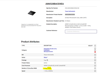

On vendor websites, AM6528BACDXEA is showing a 64bit processor while on some it is showing a 32bit processor. Could you clarify which is the actual case?
The A53 on the device are 64/32bit CPU and the R5 on the device are 32 bit CPU
