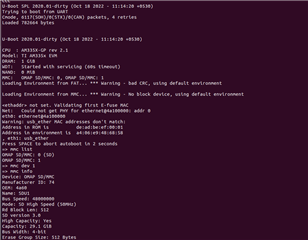

We have a custom board based on beagle bone black where SD card is slot mmc0 and emmc of 8gb in mmc1. We have managed to change dts and mux configuration to detect SD card and when we use mmc commands like mmc info and fatload command, mmc0(SD) is working. But when we change mmc1 using command mmc dev 1 it is showing nothing , no info and mmc command related to mmc dev 1 is not all working. When spl and u-boot.img load from uart loaded the booting looks like this.
when mmc dev 1 command is given and then mmc info give mmc0 information. But in mmc dev 0 proper switching is taking place.
when given command mmc dev 1 it does not switch and no operation can be done on emmc. It shows as a no block device. Our emmc in schematic look like this.

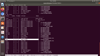

    What is the output from "dm tree" @u-boot prompt?
    -Hong
  • hello hong guan64
    this is the output of dm tree command from uboot prompt
    best regards
    eldhose peter
    It look like mmc0/mmc1 are listed and probed from "dm tree" @u-boot prompt.

    Thanks for quick reply
    Here is the output for mmc 0 and mmc1 running above commands
    When cmd mmc dev 0 is executed it properly switches to mmc 0 . And mmc info, mmc part all are working.
    But cmd  mmc dev 1 is executed it does not switch and displays the info and part of mmc 0.
    Earlier when dm tree executed mmc 1 is accepted as omap hsmmc but not as mmc_blk. How con you configure mmc1, ie emmc as block device.Is there any additional CONFIG you have to add or Is there is any CONFIG  to remove?

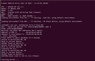

    Thanks for the reply,
    I did the compilation according to your instructions being beagle bone black as the configuration
    And I  get this
    Here you can see the emmc is acting as the same as before and mmc_blk is not enabled . Its not accepting as a block device. I did the configurations correct as you said. Is there any mistake any emmc schematic part? mmc dev 1 and cmds related to emmc are not working. Or is there any CONFIG to add.
