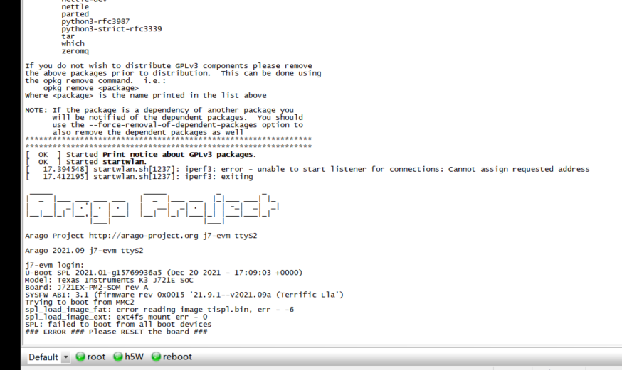

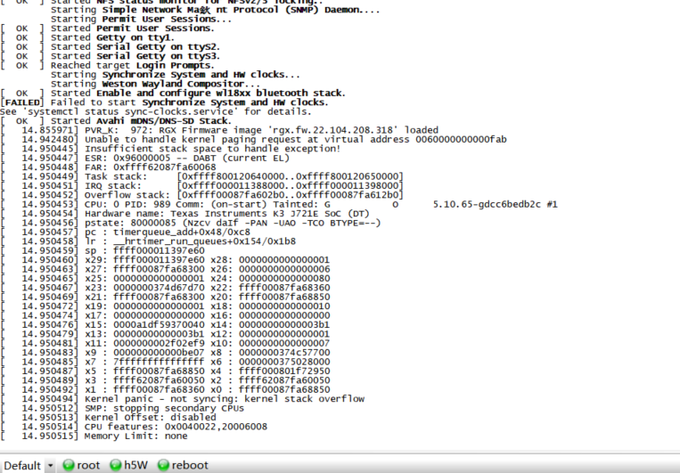

I purchase TI TDA4VM‘s EVM J721EXCP01EVM,customer currently test the EVM board, but sometimes the board often system halt.
