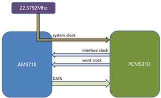

We'd like to ask you about McASP config when the system clock is connected to PCM codec without AM5718.
Based on AM5728 evm, Customer trying to implement mcasp part with AM5718 (playback function)
Referring to AM5728 below, they confirmed that it works normally in conjunction with PCM5310 as shown below.
(22.5792 was received as XI_OSC1 same as AM5728 evm and linked to mclk of PCM5310 with clkout2.
The audio sample plate is 44100 Hz.)
But similarly, if the system clock passes without going through AM5718 as shown below, sync is not correct.
And even if the interface clock is changed, the data rate is not changed.
The data is not even output according to the word clock.
(yellow: work clock, green: data(arx0), blue:interface clock)
Questions :
We wonder how to create a device tree in AM5718 to implement as follows.
Or, if you need to modify the code, please advise me which part I should modify.
They wrote the device tree as below.

We attached the device tree file and the mcasp1 setting.
