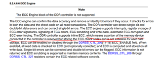

in" J721E DRA829/TDA4VM Processors Silicon Revision 1.1 Texas Instruments SPRUIL1B – MAY 2019 – REVISED DECEMBER 2020"

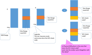

If enable DDR ECC,DDR size shall be changed logically.
Queston:
I want to know that physically,where is the ECC check code?see following picture.
cycle_1:at the end of DDR or
cycle_2:together with the data?

    background:
    for internal SRAM,ECC enabled,the size not change
    but for DDR,if ECC enabled,the size is reduced 1/9.(exampel 8G DDR for 0~8G,the available size become 0~7.111G.)
    normally, the ECC check code storage cell not  cared.
    but my customer asked that, where is the ECC check code?at the end of DDR?
    I do not know this,so,I look forwared for TI Expert Help.
