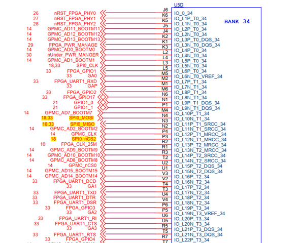

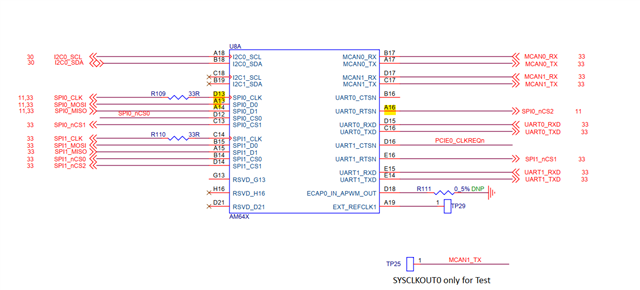

We've met a confused phenomenon for MCSPI0 transfer data using CCS XDS debug.
MCSPI0 connect with FPGA use spi 4 wire mode.

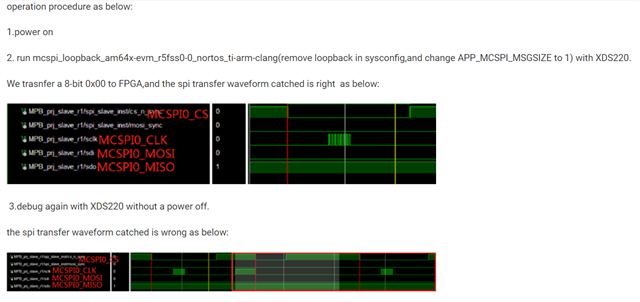

operation procedure as below:
1.power on

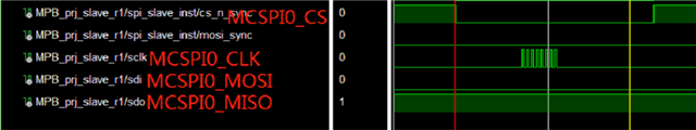

2. run mcspi_loopback_am64x-evm_r5fss0-0_nortos_ti-arm-clang(remove loopback in sysconfig,and change APP_MCSPI_MSGSIZE to 1) with XDS220.
We trasnfer a 8-bit 0x00 to FPGA,and the spi transfer waveform catched is right  as below:

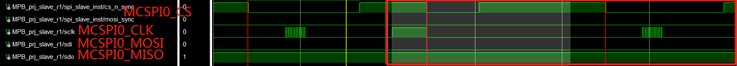

 3.debug again with XDS220 without a power off.
the spi transfer waveform catched is wrong as below:
there are a twice time CS assertion,the first time is invalid, Only the sencod time is valid.
MCSPI0_CLK deassertion should be low-level,but after setp 2 it's sustain a high-level for a while.This phenomenon is right?
