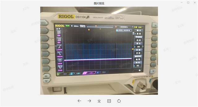

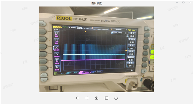

  • hello ,
    1) The pin configuration of MCU SPI0 through the SysConfig tool is as follows:
    2) The SPI we use is MCU_SPI0 and initialized in the tiboot3 code with MCU_SPI0 as the master device and FS85 as the slave device.
    3) This blue is the CS signal. It can be seen that the idle state is high, and the CS signal is normal
    4) This is the SCK signal, and you can see that when it's idle, it's low, and the SCK signal is normal
    5) This is the SDO signal, and you can see that it has a level of about 1V when it's idle, and it's not normal when it's idle
    6) This is the SDI signal. It can be seen that the level is about 1V when the SDI is idle. The signal is abnormal when the SDI is idle

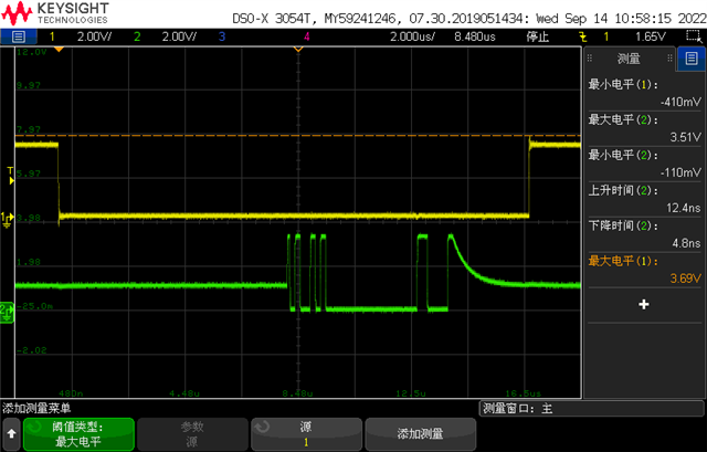

    7) Finally, the CS and SDO signals at the moment of power-on are shown below
    The purple is the CS signal, the blue is the SDO signal, and this is the signal when the board is powered on
  • Hi team,
    Check with the customer, this issue can be closed, we find the customer has configured the pins in two places in their program and finally changed the pinmux program to resolve the issue by removing the pull-up, thank you for your support for this issue.
