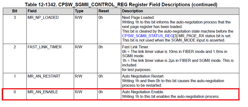

We are using DP83822I phy interfaced with DRA821 processor (CPSW5G) and would like to know the procedure to turn off auto-negotiation mode ?
Environment - TI-SDK 8.1 + QNX + RTOS setup
Currently, the interface works with auto-negotiation enabled in RMII mode but when we disable auto-negotiation on PHY side(DP89822I )link is down.
  • How can we dump the phy registers connected to the 5 port switch?
  • Are there any registers on the processor side(dra821) to disable auto-negotiation?

  • Thanks Tanmay!
    • Any tools to dump the PHY registers from QNX/RTOS cmd line? We will see if we can connect to CCS on the customer board.
      • Currently, our board works fine with auto-negotiation enabled on PHY side. Could you please let us know the procedure to operate the PHY in forced 100Mbps full duplex mode ? We tried setting  phy register 0 to 0x2100 after reset but link is down.
      • The reason for asking about the controller side auto-negotiation flag is we saw MR_AN_ENABLE for SGMII but we didn't see similar register for RMII
  • Hi Swapna,
    Things are different for SGMII and RGMII/RMII. There is no option of disabling autonegotiation for RGMII/RMII
