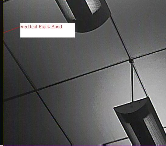

Vertical Black Band at the start of output image
Issue Description:

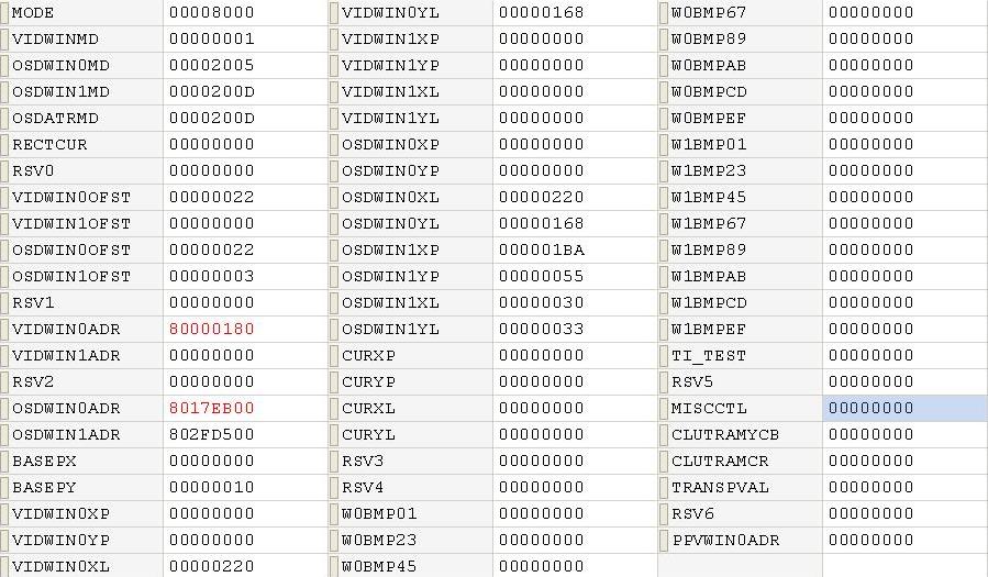

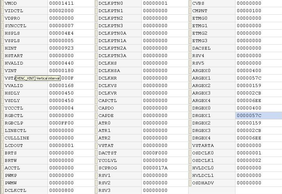

Presently I have configured the VPBE for YCC8 mode (27 MHz, Progressive).
The image is also appearing on the display but with Vertical black band at the start of image.

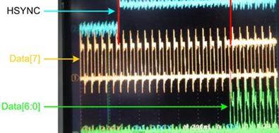

I have performed the following experiment & done the analysis on DSO. The image sent through VPBE is ALL ZERO (Y, U, V) image.
During this experiment, the data lines YOut[0] - YOut[6} shows the zero level on DSO. However YOut[7] line shows the many transtion of 0-1 & 1-0 levels (FALSE DATA).
This behavior of YOut[7] data line is causing the vertical black band issue at the start of image.
Please guide me on this issue.
