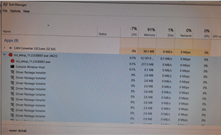

I would like to install Code Composer Studio version 12.1.0 on my laptop which running on Windows 10 Enterprise, version 21H2 build 19044.2130. However, the installation never goes to the end.
It looks like the installer is blocked in an infinite loop that creates new thread called Driver Package Installer. In less than 5 minutes more than 200 threads are created using 1.3 Gb memory in total.
Please see attached some screenshots. Is it something you are aware of? What can I do to fix this problem?

    Can the customer provide any generated logs in <CCS INSTALL DIR>\ccs\install_logs ?
    What antivirus is running on the customer PC? Did they try disabling it before installing?

    I attached the log folder to the conversation. I tried to install the version twice, so I think the correct folder would be the latest one. We are using CrowdStrike as antivirus and I don't think I am able to deactivate it for the installation. I can actually ask our IT service.

  • These are all the logs? I was expecting much more. The main install log is missing.
    Please have the customer request temporary deactivation. Or at least have them whitelist the CCS installer.

  • Thanks. This zip file has the additional log that I was looking for.
    In the main log, this appears to the where the issue occured:
    [11:35:33] CCS_INFO: In installationAbortedActionList
    [11:35:33] CCS_WARNING: Code Composer Studio 12.1.0.00007 install cancelled by user.
    [11:36:00] CCS_INFO: Return values from downloadMarker software-dl.ti.com/.../CCS12.1.0.00007_tia_windows-x64_cancelled_offline_4.zip: 200
    [11:36:01] CCS_INFO: Deleting C:\ti\ccs1210/ccs? : !false
    Cannot delete file C:/ti/ccs1210/ccs/ccs_base
    Cannot delete file C:/ti/ccs1210/ccs/eclipse
    [11:36:01] Moving logfile to C:\ti\ccs1210/ccs/install_logs/20221017112454/ccs_install_12.1.0.00007.log
    I assume the installer got stuck and the customer forced cancellation of the installer.
    I'm pretty sure the issue is do the a conflict with the antivirus software. Please let me know if the customer was able to whitelist the CCS installer
    ki

  • The IT department needs a confirmation of the location of the additional downloads.
    Note that the offline installer should come with all the packages needed to install CCS - meaning that no other packages would need to be downloaded to complete the installation. If this information sufficient?
