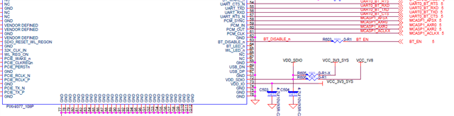

  • Hi Bin
    - you hardware setup, do you use AM62x EVM or your custom board? how is the BT device connected to WKUP UART0 port?
    custom board.
    - any kernel change to support this BT device?
    Only the device tree has been modified.

    - what program and how did you run the test?
    Loading firmware fails when using the hciattch command.
    - any Linux log showing the issue?
    root@am62xx-evm:~# hciattach -t30 /dev/ttyS1 qca 115200 flow
    qca
    frame_hci_cmd_pkt: Sending EDL_PATCH_VER_REQ_CMD
    HCI-CMD -1:     0x1     0x0     0xfc    0x1     0x19
    read_vs_hci_event: Wait for HCI-Vendor Specfic Event from SOC
    wait_for_data: Timing out on select for 3 secs.
    hci_send_vs_cmd: Failed to get HCI-VS Event from SOC
    Failed to attach the patch payload to the Controller!
    qca_soc_init: Fail to get Rome Version (0xffffff92)
    Can't initialize device: Success
    Daniel

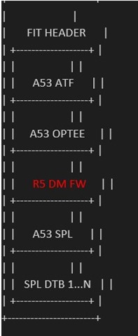

  • Hi Bin
    Customer uses the binary file to test on the SK-AM625 evm, puts the three files into the first partition of the SD card, and then uses the SD card to boot, the test result WKUP_UART0 still only sends one byte
    Is the DM firmware the file ipc_echo_testb_mcu1_0_release_strip.xer5f?
    but can't find the source code
    Is DM firmware included when making u-boot?
    How do I verify this file?
    Daniel
  • Hi Daniel,
    Yes.
    Its source code is not provided.
    Yes.
    U-Boot won't boot if the DM firmware is missing in the U-Boot binary.
