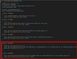

Hi, I want to test a model with 2 outputs (object detection, segmentation) on TDA4VM.
This model is similar to YOLOP.
Compilation was completed as follows, and it was confirmed that an inference was made. (based on PC)
But when I try to test it on TDA4VM, I get an error.

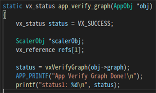

As a result of tracing through printf, an error occurs as status is -1 in the following part.
I want to know which part of vision_apps to fix when I want to test a model with 2 outputs in TDA4VM.
Thanks.

    2. My model has two outputs(object detection, segmentation). Object detection and segmentation have different post-processing methods. Is it necessary to modify vision_apps a lot to apply other post-processing to the output of the model?

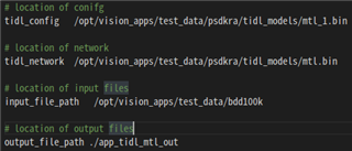

    Auto Valet Parking Application 2 is similar to what I was thinking. However, when inputting Auto Valet Parking Application 2, bin files of a completely different model are entered as input. For example:
    However, the model I have is different from the example above. It is one model and has two outputs. My model has one input, and the output of my model has the results of object detection and segmentation, respectively.
    The part of the code I wanted to modify is as follows.
    In the picture above, I thought obj->tidlObj.output_tensor_arr inside the red box was the output of the model. I thought that the model result, obj->tidlObj.output_tensor_arr[0], obj->tidlObj.output_tensor_arr[1], could be put as each post-processing input. But the graph is not created properly on app_create_graph_tidl side even before post-processing starts.
    If the model compiles properly on the pc, shouldn't app_create_graph_tidl also proceed successfully??? I'm not sure where the problem is.

    You have already provided a part of the application log in the screenshot attached in the description, but it would be helpful if I get the full logs along with the remote side logs enabled too on TDA4VM
    Could you share the logs along with the remote core logs, so that we could identify where is the error in the tidl node, that is causing failure during verify graph.
