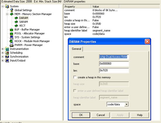

how do change the DARAM size using the configuration tools ? does it affect the .cmd file?
Hi Talmor,
Follow the below procedure
1. Double click on your tcf file in the CCS
2. Expand the menu 'System'
3. Expand the menu 'MEM - Memory Section Manager'
4. Right click on 'DARAM' and select 'properties'
5. DARAM length can be modified by changing the value shown in 'len' text box
Pratap
