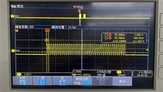

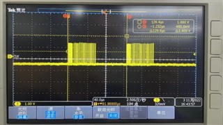

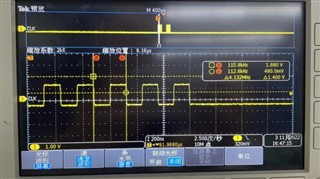

6. on board-B( mx25um51245g ), boot from ospi mode, but no text come out from debug uart. and I can see period singal on DQ0 line.
