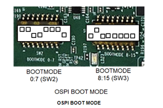

I kept the Switch pins SW2 and SW3 to 11010000 10000000 respectively. After resetting the Board the Tera Term shows nothing.
When I change the switch to xSPI i.e SW2 and SW3 to 11001110 01000000, the board boots up showing "Trying to boot from SPI". (Screenshot is attached below).
Does the board booting in OSPI mode? As its written trying to boot from SPI.
What is the correct switch configuration to boot in OSPI Mode?
How will I verify that the board is booting in OSPI?
Please help me to solve the above questions.
