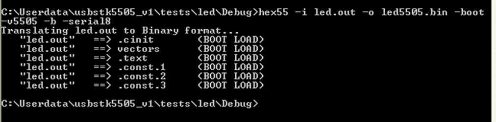

                                  i has created the binary file using the hex conversion utility    tms320c55x hexconverter v4.3.2 for the led program
    c:\program Files\Texas Instruments\ccsv4\emulation\boards\usbstk5505\tests\led\debug>hex55 -i led.out lednonencrypted.bin -boot -v5505 -b -serial8
    when i run this i get
    translating led.out to binary format
    "led.out" ==>  .cinit         <BOOTLOAD>
    "led.out" ==>  vectors     <BOOTLOAD>
    "led.out" ==>  .text           <BOOTLOAD>
    "led.out" ==>  .const.1   <BOOTLOAD>
    "led.out" ==>   .const.2  <BOOTLOAD>
    "led.out" ==>   .const.3 <BOOTLOAD>
    after this i made the copy of the led program to the c drive

  • Seeni,
    I duplicated your procedure with hex v4.3.8:
    I loaded programmer_USBKey.out to the eZdsp, input the file path:
    Input your binary file path...
    C:\Userdata\usbstk5505_v1\tests\led\Debug\led5505.bin
    SPI EEPROM...
    Writing data to device...
    Opening C:\Userdata\usbstk5505_v1\tests\led\Debug\led5505.bin...
    Input file opened
    Programming Complete
    I then disconnected the target from CCSv4, unplugged the board from the computer and plugged it in again. The program ran just fine, slower than when connected to CCS because of the clock settings, but it still ran. I'm not sure why yours isn't working.
