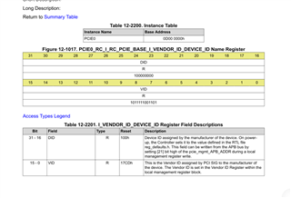

How can they change the initial value of configuration space?
After Pcie_open() in the source code, they was able to change the vendor ID by writing the value directly to the following address
They was able to change the vendor ID.
PCIE0 Physical Address = 0D10 0044h : PCIE0_I_VENDOR_ID_REG Register
Only device ID could be changed with the following address.
PCIE0 Physical Address = 0D00 0000h : PCIE0_I_VENDOR_ID_DEVICE_ID Register
Class code etc. could not be changed with the following address.
PCIE0 Physical Address = 0D00 0008h : PCIE0_I_REVISION_ID_CLASS_CODE Register
    As mentioned above, the change of vendor ID and device ID seems to have been confirmed.

    Q4:
    Question 4
    from the Linux driver they write to this register to change the device ID, i am checking with IP Expert for other queries.
