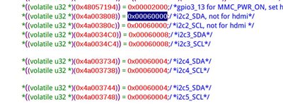

For implementing "early boot late attach" to our custom board for VSDK304, we need to enable i2c2 ~ i2c5 in uboot to control our devices. They are disabled by default. We do these:
add pinmux define
modify .dtsi
add a sensor device
but still get err in uboot
=> i2c dev 1
Setting bus to 1
Failure changing bus number (-19)
How to solve it? Thanks.

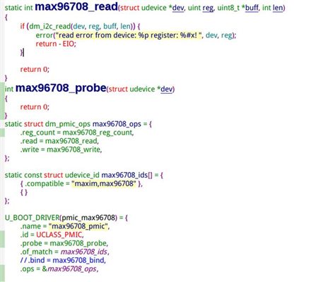

    And add a driver for our sensor: Max96708.c
    static int max96708_write(struct udevice *dev, uint reg, const uint8_t *buff,
                                   int len)
              printf("%s,%d \r\n",__func__,__LINE__);
              if (dm_i2c_write(dev, reg, buff, len)) {
                       error("write error to device: %p register: %#x!", dev, reg);
                       return -EIO;
              return 0;
    static int max96708_read(struct udevice *dev, uint reg, uint8_t *buff, int len)
              if (dm_i2c_read(dev, reg, buff, len)) {
                       error("read error from device: %p register: %#x!", dev, reg);
                       return -EIO;
              return 0;
    static int max96708_bind(struct udevice *dev)
              int pmic_node = -1, regulators_node;
              const void *blob = gd->fdt_blob;
              int children;
              int node = dev->of_offset;
              int subnode, len;
              fdt_for_each_subnode(blob, subnode, node) {
                       const char *name;
                       char *temp;
                       name = fdt_get_name(blob, subnode, &len);
                       temp = strstr(name, "pmic");
                       if (temp) {
                                 pmic_node = subnode;
                                 break;
              #if 0
              if (pmic_node <= 0) {
                       debug("%s: %s pmic subnode not found!", __func__, dev->name);
                       return -ENXIO;
              regulators_node = fdt_subnode_offset(blob, pmic_node, "regulators");
              if (regulators_node <= 0) {
                       debug("%s: %s reg subnode not found!", __func__, dev->name);
                       return -ENXIO;
              children = pmic_bind_children(dev, regulators_node, pmic_children_info);
              if (!children)
                       debug("%s: %s - no child found\n", __func__, dev->name);
              #endif
              /* Always return success for this device */
              return 0;
    static struct dm_pmic_ops max96708_ops = {
    //      .reg_count = max96708_reg_count,
              .read = max96708_read,
              .write = max96708_write,
    static const struct udevice_id max96708_ids[] = {
              { .compatible = "maxim,max96708" },
    U_BOOT_DRIVER(pmic_max96708) = {
              .name = "max96708_pmic",
              .id = UCLASS_PMIC,
              .of_match = max96708_ids,
              .bind = max96708_bind,
              .ops = &max96708_ops,
    Power on, and we get:

    Did we modify the dts file correctly? How should we write the max96708 driver file? Thanks.
