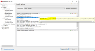

  • If you expand the include path what does it show? Does it show TivaWare_C_Series-2.1.4.178?
    I will suggest you also create a new workspace and reimport the example to the new workspace again.
    Please see below for customer feedback:
    "As You can see it looks fine and I have been messing with the includes, chasing the errors but I couldn't make it work
    I can only imagine it has something to do with this warning but I just can't figure why it sees them as invalid paths
    OK I managed to compile it but it turns out that I had to compile it using the TivaWare_C_Series-2.1.1.71 because it refused to work with the TivaWare_C_Series-2.1.4.178 and I had to go to the include path and change the directories manually because they were automatically set to TivaWare_C_Series-2.1.4.178."

  • Can you hover over the three dots and see how the include paths expand.
    Then go to file explorer and do you see your TivaWare installed at the expected directory?
    As I suggested earlier, did you try to import into a new work space and try again?
