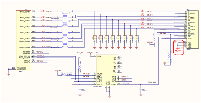

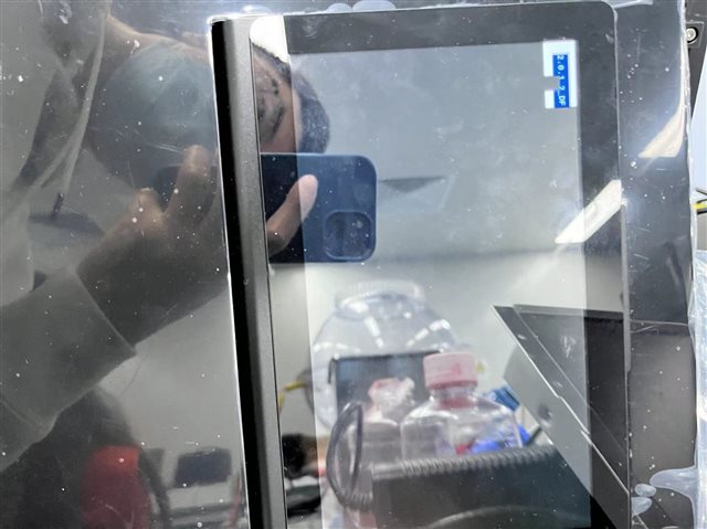

I connected the controller AM5728 to the screen through the HDMI interface, but there was something wrong with the screen as shown in the first picture. The circuit diagram is shown in the following picture, and I noticed that the SGX544 had been in the initialization state through the serial port until the initialization failed. Could you please tell what might have caused such a problem? Thanks.

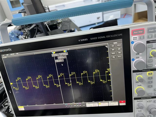

Besides, this is the tested HDMI signal waveform. There are no differences in the waveforms before and after the inductance.

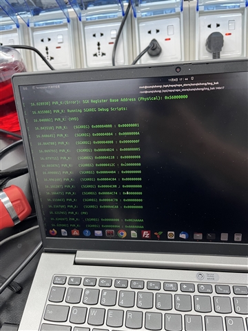

  • The screen can show text files, but errors appear when the screen shows image files. The errors are as follows. Could you please tell me what might have caused this?
    am57xx-evm login: [   34.327750] omap_l3_noc 44000000.ocp: L3
    application error: target 5 mod:1 (unclearable)
    [   34.335907] omap_l3_noc 44000000.ocp: L3 debug error: target 5 mod:1
    (unclearable)
    [   34.540907] PVR_K:(Error): SGXOSTimer() detected SGX lockup (0x2d03
    tasks)
    [   34.547822] PVR_K: HWRecoveryResetSGX: SGX Hardware Recovery
    triggered
    [   34.554838] PVR_K: SGX debug (SGX_DDK_Linux_XOrg sgxddk
    1.17@4948957)
    [   34.561516] PVR_K:(Error): SGX Register Base Address (Linear):
    0x02134669
    [   34.568515] PVR_K:(Error): SGX Register Base Address (Physical):
    0x56000000
    [   34.575950] PVR_K: Running SGXREG Debug Scripts:
    [   34.580594] PVR_K: (HYD)
    [   34.583147] PVR_K:         (SGXREG) 0x00004000 : 0x00000001
    [   34.588149] PVR_K:         (SGXREG) 0x00004004 : 0x0000000A
    [   34.593144] PVR_K:         (SGXREG) 0x00004008 : 0x0000000F
    [   34.598136] PVR_K:         (SGXREG) 0x00004024 : 0x00000005
    [   34.603130] PVR_K:         (SGXREG) 0x00004118 : 0x00000008
    [   34.608122] PVR_K:         (SGXREG) 0x0000412C : 0x20000000
    [   34.613116] PVR_K:         (SGXREG) 0x00004404 : 0x00000000
    [   34.618109] PVR_K:         (SGXREG) 0x00004C04 : 0x00080000
    [   34.623102] PVR_K:         (SGXREG) 0x00004C08 : 0x00000000
    [   34.628095] PVR_K:         (SGXREG) 0x00004C74 : 0x00000000
    [   34.633089] PVR_K:         (SGXREG) 0x00004C78 : 0x00000000
    [   34.638080] PVR_K:         (SGXREG) 0x00004CA8 : 0x00000008
    [   34.643073] PVR_K: (P0)
    [   34.645535] PVR_K:         (SGXREG) 0x00008000 : 0x002AAAAA
    [   34.650526] PVR_K:         (SGXREG) 0x00008004 : 0x0A8A8AAA
    [   34.655520] PVR_K:         (SGXREG) 0x00008008 : 0x0103BB87
    [   34.660512] PVR_K:         (SGXREG) 0x00008118 : 0x000000A8
    [   34.665504] PVR_K:         (SGXREG) 0x0000812C : 0x24142600
    [   34.670496] PVR_K:         (SGXREG) 0x000084E4 : 0x00000008
    [   34.675489] PVR_K:         (SGXREG) 0x00008658 : 0x00000000
    [   34.680481] PVR_K:         (SGXREG) 0x00008A74 : 0x0E208200
    [   34.685511] PVR_K:         (SGXREG) 0x00008BA4 : 0x00000001
    [   34.690503] PVR_K:         (SGXREG) 0x00008C04 : 0x00080000
    [   34.695497] PVR_K:         (SGXREG) 0x00008C08 : 0x00000000
    [   34.700488] PVR_K:         (SGXREG) 0x00008C74 : 0x00000000

  • And there's also a problem when the device is displaying pictures. The picture can't be displayed well, and I have no idea what has caused this.

  • Hello Katherine,
    You shared a circuit diagram. Is this a custom board? Or a TI EVM?
    Erick
  • Hello Erick,
    The board was drawn by me. Is there a problem with the wiring? Could you please tell me problems with which part of the wires could have caused this?
    Katherine
  • Katherine,
    I've requested our HW team to do a quick review of the schematic you shared.
