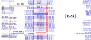

  • Dear Experts,
         Some details from customers:
         1. They confirm their modification based on SDK8.2 is usable. However it is difficult for them to test all the modification step by step since most of the modification are related to hardware. So they cannot test in a default SDK8.4 environment.
         2. During merge,they find some codes in 8.2 cannot find corresponed one in SDK8.4. For example, there are some changes in pdk/packages/ti/drv/enet/examples/utils/V1. As a result, they are not quite sure if their merge is correct. Some of the changes are related to hardware, so they need to do the merge otherwise their board cannot boot.
        3. Here are their changes:
        3.1 modification based on SDK8.2
    sdk0802_adcudev_delta.zip
        3.2 modification based on the merge of SDK8.4
    sdk0804mod_delta.zip
        3.3 RGMII SCH
        4. Their current configuration: RGMII2 -> PHY2; RGMII3 -> PHY1; RGMII4 -> PHY4, RGMII6 for board internal communication.
    Dear Baorui,
         When you say internal communication does it mean MAC-MAC?
    BR
    Sikai
  • Hi Sikai,
    Yes it is MAC-MAC connection.
    Hui Baorui
