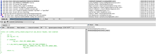

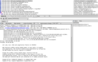

    For VSC8514, we see there is only a patch from TI in Linux kernel(TI SDK 08_04_00) to enable SerDes:
    It requires to enable auto-negotiation by configuring MAC SerDes PCS control register.

  • Hello Richard,
    The patch that you are referring to, is for adding the missing Auto-Negotiation
    feature to the mscc PHY driver. The mscc PHY driver is responsible for controlling
    the VSC8514 PHY. This auto-negotiation feature that was added, is only specific to
    VSC8514 PHY. If you are using a different PHY, ideally, the PHY driver would have
    already implemented this feature and therefore, no additional changes would be
    required in the PHY driver.
    I hope that answers your question. Please let me know if further information is
    required.
