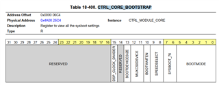

Hi TI team,
We are using DRA725 with booting from SD card mode(class 4) and it's bootable.
Now we change the a new SD card class10 32G and we get the following error while MLO loading u-boot.img.
After flashing the SD card to eMMC and boot from eMMC, it's bootable. Hence it seems like it's an issue while MLO reading u-boot.img from SD card.

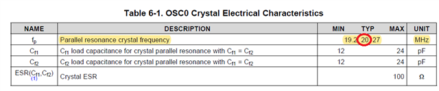

  • Gibbs, this issue may be crystal changing from 19.2MHz to 20MHz related. We could boot from class10 SDCARD with crystal 19.2MHz, but it failed after changing to 20.0MHz crystal.
    1. We don't have EVM.
    2. I do the following changes, it is still not bootable.

    Step1. If crystal (OSC0 crystal) = 19.2Mhz, SD Class 10 & Class 4 BOOT well? (y/n)
    Step2. And then, You modify crystal (OSC0 crystal) from 19.2MHz to 20MHz on you "customized board"
    Step3. After rework crystal (OSC0 crystal) = 20.0Mhz,  you found SD class 10 boot fail, how about class 4 SD?
    Step4 if you copy the boot file to on board eMMC, and then switch to eMMC boot, boot is fine even (OSC0 crystal) = 20.0Mhz)? (y/n)
    My opinion, SD boot fail just appearance, How to modify software code to match (OSC0 crystal) = 20.0Mhz is root cause problem.(y/n)
    max-frequency = <192000000>, "max-frequency" should be max "fop(clk)", not OSC0 crystal frequency, please check sheet p.306, SDR1041,
    UHS SD should be work fine. but for MMC1, The max frequency should be keep 192MHz
    pinctrl-names should be keep :
    pinctrl-names = "default", "hs", "sdr12", "sdr25", "sdr50", "ddr50", "sdr104";
    May you also join this discussion to help me solve this problem.

  • Hi Gibbs,
    Sorry for making you confused.
    [Kevin] yes.
    [Kevin] class 4 SD boot fine.
    [Kevin] yes, the SOC with OSC0 crystal(20MHz) boot fine from eMMC.
    [Kevin] I'm not pretty sure, because let's compare test1 with test2 and it seems like OSC(19.2MHz -> 20MHz) doesn't matter. But let's compare test3 with test4 and it seems like OSC does matter.I make a test matrix with the same uboot(w/o compiled with dts).
    DRA725 with 19.2MHz DRA725 with 20MHz
    class 4 SD boot fine(test1) boot fine(test2)
    class 10 SD boot fine(test3) boot NG(test4)

    4.  Do we need to do some SW modify in u-boot or linux device tree for OSC0 crystal setting? If yes, How?

  • Kevin,
    May you also check  "CTRL_CORE_BOOTSTRAP" register, bit 9:8 ?
    Many Thanks]
    Gibbs
  • Gibbs,
    I read "CTRL_CORE_BOOTSTRAP" register for 20MHz crystal, it's value is 0xad98, bit 9:8 is 0x1, which means 20MHz, it's correct.
    for 19.2 MHz, it's value is 0x8318, bit 9:8 is 0x3, 0x3 means 19.2 MHz, it's correct.
    I also read register CM_CLKSEL_SYS(0x4ae06110), for 20MHz, it's value is 0x2, which means 20MHz.
    And 19.2 MHz, it's value is 0x4, which means 19.2MHz.
  • Hi, Keerthy
    I summarize some notes.
    (1) Customer use DRA725 ES2.1 for their customized board,  OSC0 crystal = 20.0 MHZ.  UBoot class 10 SD card Boot fail (mmc1) .
    (2) Follow previously step. They swap to eMMC boot(mmc2) on the same board, eMMC boots well, and they can access eMMC1 class 10 SD Card.
    We do not know the reason Why class10 SD boot fail, it should be some u-boot problems.
    HLOS (Linux) can R/W class10 SD(mmc1), it should be not hardware issue.
    as far as I know, SD should always works on 3.3v high speed mode on their customized board
    May you give us some correct software setting base on eMMC1 class10 SDOSC0 crystal = 20.0 MHZ (ex:u-boot device tree)
    I think Class 10  SD should be boot well, because it's not UHS-1 or UHS-II SD card.
    Many Thanks
    Gibbs
