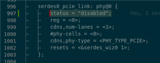

Following the guideline: Enable8PortEth_J7EVM_SDK7p1_public.pdf I modified device tree like this:

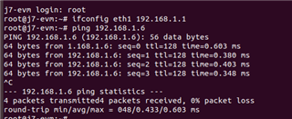

With this EthFw image above, I can enable Ethfw QSGMII and communicate ethernet:

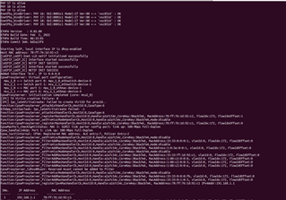

    This is log of ethfw which extracted from tisdk-default-image-j7-evm.tar.xz (I downloaded ti-processor-sdk-linux-j7-evm-08_04_00_11 form TI and get  tisdk-default-image-j7-evm.tar.xz):
    Enabling clocks!
                CPSW Ethernet Firmware
    ETHFW: Shared multicasts (software fanout):
      01:00:5e:00:00:01
      01:00:5e:00:00:fb
      01:00:5e:00:00:fc
      33:33:00:00:00:01
      33:33:ff:1d:92:c2
      01:80:c2:00:00:00
      01:80:c2:00:00:03
    ETHFW: Reserved multicasts:
      01:80:c2:00:00:0e
      01:1b:19:00:00:00
    EnetMcm: CPSW_9G on MAIN NAVSS
    PHY 16 is alive
    PHY 17 is alive
    PHY 18 is alive
    PHY 19 is alive
    EnetPhy_bindDriver: PHY 16: OUI:0001c1 Model:27 Ver:00 <-> 'vsc8514' : OK
    EnetPhy_bindDriver: PHY 17: OUI:0001c1 Model:27 Ver:00 <-> 'vsc8514' : OK
    EnetPhy_bindDriver: PHY 18: OUI:0001c1 Model:27 Ver:00 <-> 'vsc8514' : OK
    EnetPhy_bindDriver: PHY 19: OUI:0001c1 Model:27 Ver:00 <-> 'vsc8514' : OK
    ETHFW Version   : 0.02.00
    ETHFW Build Date: Feb  2, 2022
    ETHFW Build Time: 06:33:05
    ETHFW Commit SHA: bd5a13f4
    Starting lwIP, local interface IP is dhcp-enabled
    Host MAC address: 70:ff:76:1d:92:c3
    [LWIPIF_LWIP] Enet LLD netif initialized successfully
    [LWIPIF_LWIP_IC] Interface started successfully
    [LWIPIF_LWIP_IC] NETIF INIT SUCCESS
    Added interface 'br4', IP is 0.0.0.0
    CpswProxyServer: Virtual port configuration:
      mpu_1_0 <-> Switch port 0: mpu_1_0_ethswitch-device-0
      mcu_2_1 <-> Switch port 1: mcu_2_1_ethswitch-device-1
      mpu_1_0 <-> MAC port 1: mpu_1_0_ethmac-device-1
      mcu_2_1 <-> MAC port 4: mcu_2_1_ethmac-device-4
    CpswProxyServer: initialization completed (core: mcu2_0)
    CpswMacPort_checkSgmiiStatus: MAC 5: SGMII link parter config port: link up: 100-Mbps Full-Duplex
    Cpsw_handleLinkUp: Port 5: Link up: 100-Mbps Full-Duplex
    REMOTE_SERVICE: Init ... !!!
    REMOTE_SERVICE: Init ... Done !!!
    Function:CpswProxyServer_attachExtHandlerCb,HostId:0,CpswType:6
    Function:CpswProxyServer_registerMacHandlerCb,HostId:0,Handle:a2a7c54c,CoreKey:38acb7e6, MacAddress:70:ff:76:1d:92:c2, FlowIdx:173, FlowIdxOffset:1
    Function:CpswProxyServer_setPromiscModeHandlerCb,HostId:0,Handle:a2a7c54c,CoreKey:38acb7e6,mode:disable
    Function:CpswProxyServer_registerMacHandlerCb,HostId:0,Handle:a2a7c54c,CoreKey:38acb7e6, MacAddress:70:ff:76:1d:92:c1, FlowIdx:172, FlowIdxOffset:0
    Cpsw_ioctlInternal: CPSW: Registered MAC address. ALE entry:7, Policer Entry:2
    Function:CpswProxyServer_filterAddMacHandlerCb,HostId:0,Handle:a2a7c54c,CoreKey:38acb7e6, MacAddress:33:33:0:0:0:1, vlanId:0, FlowIdx:172, FlowIdOffset:0
    Function:CpswProxyServer_filterAddMacHandlerCb,HostId:0,Handle:a2a7c54c,CoreKey:38acb7e6, MacAddress:1:0:5e:0:0:1, vlanId:0, FlowIdx:172, FlowIdOffset:0
    Function:CpswProxyServer_filterAddMacHandlerCb,HostId:0,Handle:a2a7c54c,CoreKey:38acb7e6, MacAddress:33:33:ff:1d:92:c1, vlanId:0, FlowIdx:172, FlowIdOffset:0
    Function:CpswProxyServer_filterAddMacHandlerCb,HostId:0,Handle:a2a7c54c,CoreKey:38acb7e6, MacAddress:33:33:0:0:0:fb, vlanId:0, FlowIdx:172, FlowIdOffset:0
    Function:CpswProxyServer_filterAddMacHandlerCb,HostId:0,Handle:a2a7c54c,CoreKey:38acb7e6, MacAddress:1:80:c2:0:0:0, vlanId:0, FlowIdx:172, FlowIdOffset:0
    Function:CpswProxyServer_filterAddMacHandlerCb,HostId:0,Handle:a2a7c54c,CoreKey:38acb7e6, MacAddress:1:80:c2:0:0:3, vlanId:0, FlowIdx:172, FlowIdOffset:0
    Function:CpswProxyServer_filterAddMacHandlerCb,HostId:0,Handle:a2a7c54c,CoreKey:38acb7e6, MacAddress:1:80:c2:0:0:e, vlanId:0, FlowIdx:172, FlowIdOffset:0
    CpswProxyServer_isRsvdMcast: Reserved mcast cannot be added to filter
    Function:CpswProxyServer_filterAddMacHandlerCb,HostId:0,Handle:a2a7c54c,CoreKey:38acb7e6, MacAddress:33:33:0:1:0:3, vlanId:0, FlowIdx:172, FlowIdOffset:0
    Function:CpswProxyServer_registerIpv4MacHandlerCb,HostId:0,Handle:a2a7c54c,CoreKey:38acb7e6, MacAddress:70:ff:76:1d:92:c1 IPv4Addr:192.168.1.1
     SNo.      IP Address          MAC Address
      1       192.168.1.1     70:ff:76:1d:92:c1
    Function:CpswProxyServer_filterAddMacHandlerCb,HostId:0,Handle:a2a7c54c,CoreKey:38acb7e6, MacAddress:1:0:5e:0:0:fb, vlanId:0, FlowIdx:172, FlowIdOffset:0
    Function:CpswProxyServer_filterAddMacHandlerCb,HostId:0,Handle:a2a7c54c,CoreKey:38acb7e6, MacAddress:1:0:5e:0:0:fc, vlanId:0, FlowIdx:172, FlowIdOffset:0

    root@j7-evm:~# ifconfig eth1 192.168.1.1
    root@j7-evm:~# ping 192.168.1.6
    PING 192.168.1.6 (192.168.1.6): 56 data bytes
    64 bytes from 192.168.1.6: seq=0 ttl=64 time=8.494 ms
    64 bytes from 192.168.1.6: seq=1 ttl=64 time=2.657 ms
    64 bytes from 192.168.1.6: seq=2 ttl=64 time=1.132 ms
    64 bytes from 192.168.1.6: seq=3 ttl=64 time=1.116 ms

  • Hi Sudheer,
    Wireshark didn't show any packet when I make a ping test
    And this is log of Ethfw when I run ethtool before and after making the ping test:
    Function:CpswProxyServer_regrdHandlerCb,HostId:0, RegAddr:c000000
    Function:CpswProxyServer_regrdHandlerCb,HostId:0, RegAddr:c020000
    Function:CpswProxyServer_clientNotifyHandlerCb,HostId:0,Handle:38acb7e6,CoreKey:a2a495a4,NotifyId:RPMSG_KDRV_TP_ETHSWITCH_CLIENTNOTIFY_DUMPSTATS,NotifyLen
         0: Vlanid: 012c, UTagged: 1ff, Mult: 1ff, UMult: 0, Member: 1ff RAW:[0 212c1ff1 ff0001ff]
         1: Vlanid: 0000, UTagged: 13, Mult: 13, UMult: 13, Member: 13 RAW:[0 20000130 13013013]
         2: Vlanid: 0001, UTagged: 1ed, Mult: 1ed, UMult: 0, Member: 1ed RAW:[0 20011ed1 ed0001ed]
         3: Address: ffffffffffff, Member:1ff Su=0 FWDSTLVL=0 IGNMBITS=0 RAW:[7fc 1000ffff ffffffff]
         4: Address: 70ff761d92c3, Port: 000 Se=1 Bl=0 TOUCH=0 AGE=0 TRUNK=0 RAW:[1 100070ff 761d92c3]
         5: EtherType: 0806 RAW:[1 20000000 00000806]
         6: Address: 70ff761d92c2, Port: 000 Se=1 Bl=0 TOUCH=0 AGE=0 TRUNK=0 RAW:[1 100070ff 761d92c2]
         7: Address: 70ff761d92c1, Port: 000 Se=0 Bl=0 TOUCH=0 AGE=0 TRUNK=0 RAW:[0 100070ff 761d92c1]
         8: Address: 333300000001, Member:001 Su=0 FWDSTLVL=0 IGNMBITS=0 RAW:[4 10003333 00000001]
         9: Address: 01005e000001, Member:001 Su=0 FWDSTLVL=0 IGNMBITS=0 RAW:[4 10000100 5e000001]
        10: Address: 3333ff1d92c1, Member:1ed Su=0 FWDSTLVL=0 IGNMBITS=0 RAW:[7b4 10003333 ff1d92c1]
        11: Address: 0180c2000000, Member:001 Su=0 FWDSTLVL=0 IGNMBITS=0 RAW:[4 10000180 c2000000]
        12: Address: 0180c2000003, Member:001 Su=0 FWDSTLVL=0 IGNMBITS=0 RAW:[4 10000180 c2000003]
        13: Address: 3333000000fb, Member:1ed Su=0 FWDSTLVL=0 IGNMBITS=0 RAW:[7b4 10003333 000000fb]
        14: Address: 333300010003, Member:1ed Su=0 FWDSTLVL=0 IGNMBITS=0 RAW:[7b4 10003333 00010003]
        15: Address: 01005e0000fc, Member:001 Su=0 FWDSTLVL=0 IGNMBITS=0 RAW:[4 10000100 5e0000fc]
        16: Address: 01005e0000fb, Member:001 Su=0 FWDSTLVL=0 IGNMBITS=0 RAW:[4 10000100 5e0000fb]
    1007 Free Entries
        0: POLICER_DST_MAC,ALE Index: 3
        0: POLICER_ETHERTYPE,ALE Index: 5
        0: POLICER_THREAD,THREAD ID:4

    I install the linux sdk 8.04 following your guideline but the same result: I can't ping successfully if I replace the new image built from RTOS SDK. With the default ethfw in sdk, I can ping successfully
    I also tried to install ti-processor-sdk-rtos-j721e-evm-08_04_00_06-prebuilt.tar.gz from https://www.ti.com/tool/download/PROCESSOR-SDK-RTOS-J721E/08.04.00.06 but the same result like above.
    How you run ping with QSGMII with ethfw image built from RTOS SDK. Could you provide me your steps?

  • Hi Dinh,
    I have followed below steps to confirm ping with QSGMII.
    1) Flashed SD card with Linux SDK by following the below document (section 1.1.1, 1.1.2 and 1.1.3)
    https://software-dl.ti.com/jacinto7/esd/processor-sdk-linux-jacinto7/08_04_00_11/exports/docs/linux/Overview/Download_and_Install_the_SDK.html
    2) Build ethfw from RTOS SDK using below commands.
    • make ethfw_all_clean BUILD_SOC_LIST=J721E
    • make ethfw_all BUILD_SOC_LIST=J721E
    3) Inserted SD card to PC as flash device.
    4) Replaced the ethfw binary in "rootfs/lib/firmware/ethfw" rootfs partition of SD card with above build ethfw image.
    5) Enabled QSGMII using below steps.
    1. Stop booting at uboot.
    2. Set environement variable as per below command.
      1. root@j7-evm:~# setenv dorprocboot 1
    3. Save environment using below command.
      1. root@j7-evm:~# saveenv
    4. After above do power cycle of board.
    6) Connected QSGMII port to PC and configured static IP at both sides (PC and eth1 of A72) and confirmed ping and iperf.
    Sudheer
