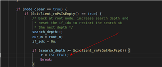

  • Hi ,Brijesh
    I found that the program returned CSL_EFAIL on Sciclient_rmIrqFindRoute, as shown in the following figure:
    What is the reason for returning CSL_EFAIL?
    bingxian
  • Hi bingxian,
    Can you please run a loop on IRQ number from 0 to 512 on R5F core and see if it succeeds for any irq number?
    If this also does not work, we may have configure individual interrupt router to route interrupt to R5F.
    Brijesh
