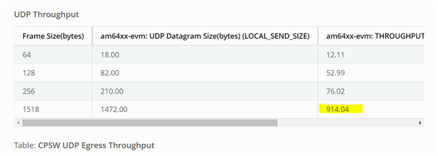

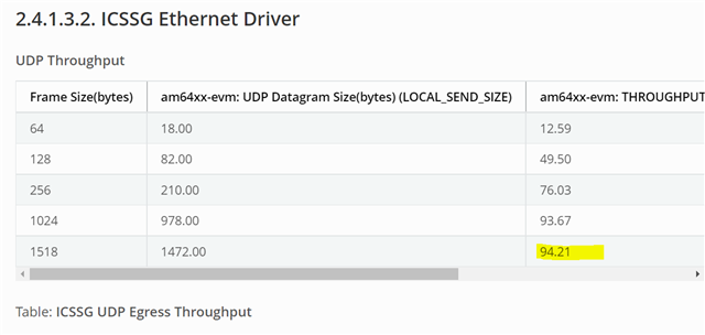

The ICSSG UDP Egress throughput is only 94.21Mbps,
While CPSW UDP Egress is as expected as 914Mbps
Could you clarify?

    The commands to test the UDP throughput should be thoroughly documented here: https://software-dl.ti.com/processor-sdk-linux/esd/AM64X/08_04_01_04/exports/docs/devices/AM64X/RT_Linux_Performance_Guide.html#ethernet
    I agree that less than 100Mbit throughput does not make sense if the PRU_ICSSG Ethernet was tested on a gigabit link. Do you have an EVM to run tests? If not I can try it out later this week.
    Nick
  • Hi Nick,
    We used iperf to test AM64x PRU ICSSG Ethernet TCP is 800~900Mbps, and UDP 400M(%0 loss)~600M(<1% loss), but Linux SDK doc show PRU ICSSG performance is much poor (90Mbps), please help clarify to avoid customer confuse.
    -Thomas
  • Hello Thomas,
    I see similar results using netperf (reported throughput of 720 Mbits for UDP egress tests). I'll file a ticket against the documentation and double-check on the testing methodology.

    Thanks for reporting,
    Nick
