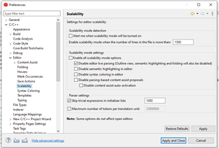

Recently, I came across a curious situation:
using CCS v10.1.0 I noticed that "folding" automatically disabled once over 1500 rows.
If I write the line 1501, than save, than close and reopen the header or the source file, all the collapsed rows are now expanded and there is not the possibility to restore the folding.
Is it a default configuration? There is a way to modify the "maximum number of code lines" ?
