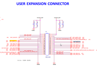

I want to toggle GPIO  EXP_GPIO0_38 of user exp header of SK-AM62 board,  through command line and used pre built image
Step followed

value are not changing  and on gpio line, getting always 0.64v
is I need to do any thing else?
please give suggestion
