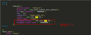

I want to use the following pins to generate a 500K
clock.
https://software-dl.ti.com/tisci/esd/latest/5_soc_doc/j721e/clocks.html
I checked clk and ran it, but there was no waveform output.
The dts is as follows:

elmos@0 {
pinctrl-names = "default";
pinctrl-0 = <&spi_e521_clkref_pins_default>;
spi-max-frequency = <2000000>;
reg = <0>;
compatible = "elmos,e521.42";
clocks = <&k3_clks 157 82>;
clock-names = "elmos";
code:
ref_clk = devm_clk_get(&spi->dev,"elmos");
ret = clk_prepare_enable(ref_clk);
dev_dbg(&spi->dev, "elmosclk_prepare_enable ret%d\n",ret);

The results of the pinmux detection were as follows (mode 2):
But there was no waveform output to the corresponding pin.
  • cat /sys/kernel/debug/clk/clk_summary
    enable prepare protect duty
    clock count count count rate accuracy phase cycle
    clk:157:82 1 1 0 0 0 0 50000
  • It didn’t work even though I switched to the mode 0.
  • It didn't work either, even though this was increased.
    Is this a PWM pin?
    ecap0_in_apwm_ou
    Can I set it as a PWM one? If so, how can I set the output as 500k?

  • Is this a PWM pin?
    ecap0_in_apwm_ou
    Yes, it can be exported from this module, but it seems the registers of the operation module may crash.
    They will also crash under the read-only mode. We are using SDK 7.3 for the time being. We tried in Linux and U-boot, and the same thing happened.
  • Can I set it as a PWM one? If so, how can I set the output as 500k?
    Yes, as above, to generate a PWM output, a 500K square wave would be enough.
