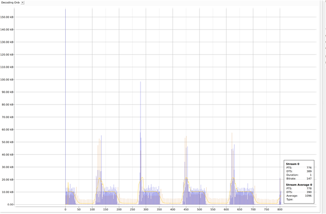

  • Hi Nikshith,
    When I enabled the CBR mode, we observed the bitrate achieved is not consistent and under achieved for the same video contents.
    ctx->rc.rc_mode =IMG_RCMODE_CBR
    Example, if we set 2.5Mbps, we are getting 1.5Mbps. The bitrate graph is shown below -
    Gajanan

  • Hi Gajanan,
    Can you give more clarity on the graph attached.
    1. What is X-axis and Y-axis denoting?
    2. What is the tool used to generate the graph. Is it open-source?
    3. You have mentioned a bitrate of 1.5Mbps. Can you let us know, how did you infer that from the graph attached?
    4. The graph seems to have periodic nature. Can you share the raw .yuv file?
  • HI Nikshith,
    X-axis ==> Frame Number
    Y-axis ==> Bytes consumed
    github.com/.../releases
    If you open the genrated bit-stream in above shared tool, you will get these details
    This behaviour is observed with real time capture and encoding. So I dont have yuv available. And also encoded stream I cannot share it here due to confidentiality.  Since you are able to reproduce the issue at your end, I don't see any requirement of sharing this.
    Kindly let me know if you need more details.
    Gajanan

  • Hi Nikshith,
    Please use the below attached files -
    8865.txt
    2364.txt
    Rename the above RAW video files from .txt to .yuv (e.g 8865.txt to 1.yuv & 2364.txt to 2.yuv)
    Create the input raw file combination of black and actual raw video -
    cat 1.yuv 2.yuv 1.yuv 2.yuv 1.yuv 2.yuv 1.yuv 2.yuv 1.yuv 2.yuv 1.yuv 2.yuv 1.yuv 2.yuv 1.yuv 2.yuv > input_704x512_nv12.yuv
    Execute the below to generate CBR and VBR streams (Note the driver needs to be changed to change the modes CBR/VBR).
    BITRATE is 2.5mbps, gop is 30, intra interval is 5, nv12 format
    ./tienc_encode -i input_704x512_nv12.yuv -w 704 -h 512 -b 2500000 -p 5 -g 30 -o output_2.5Mbps_cbr.264
    ./tienc_encode -i input_704x512_nv12.yuv -w 704 -h 512 -b 2500000 -p 5 -g 30 -o output_2.5Mbps_vbr.264
    The result summary is below -
    For CBR the encoded files bit-rate is under achieved and VBR bit-rate is overshoot
     CBR - 1.56Mbps (Underachieved)
    VBR - 5.3Mbps (Overshoot)
    Gajanan
  • Hi Gajanan,
    CBR and VBR are working fine with the above basket ball video.
    We could replicate the issue at our end. Saw under achievement in CBR and Overshoot in VBR. We are debugging the issue.
