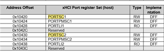

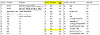

  • Miyazaki-san,
    The response I have received:
    "There are like 3 layers:
    • Xchi spec defines the generic register
    • The DWC controller defines an instance
    • TI wraps (bus+clock+power) and integrates a couple instances of the DWC into our SOC
    -1-
    XHCI:
    The PORTSC (port status and control register) and the PP[9] (port power) field are in the xchi spec.  Their offset is defined there.
    • Address: Operational Base + (400h + (10h * (n–1)))
    -2-
    DWC:
    The DWC controller figures strangely compress the field names:
    -3-
    TI:
    -Thanks,
    Shreyas
