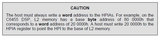

Is it possible to access any memory location during boot mode of the tms320c6455 ?
My scenario :  from a host processor
1>  put the dsp in hpi boot and tried to write into and read memory but tht didnt work. Tried to read the pci base reg which holds the vendor id but tht didnt help either.
2>put the dsp in no boot mode and tried to write and read but could not do that either.
